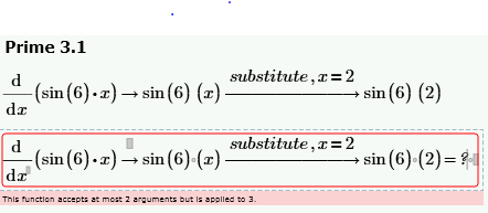

Why is differentation of const. times x giving const. (x)?
In Prime 3.1 symbolic evaluation of d (sin(6) x)/dx yields sin(6) (x), while I expected sin(6).
What did I misunderstand?
/Henning

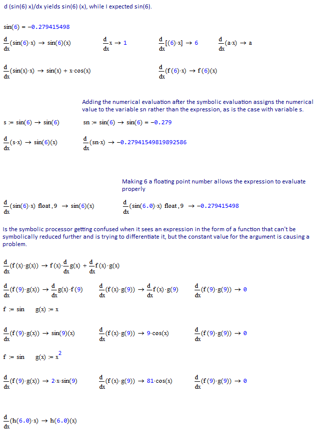

June 23, 2016
Interesting.  The same thing happens in Mathcad 15 ... same symbolic engine, as far as I'm aware.
Stuart
23-Emerald V
June 23, 2016
... Forgot to add that replacement of g = x by g = x^2 seems to give the correct answer, so it may be something to do with just x being miscalculated (or some assumption that I'm making that the symbolic processor isn't!).
.... this also seems vaguely familiar - I have a slight sense of deja vu.
Stuart
June 23, 2016
Neither Prime nor MC15 can evaluate its own symbolic result numerically when the variable is replaced by a number:DiffPrime3.1.PNG
/Henning

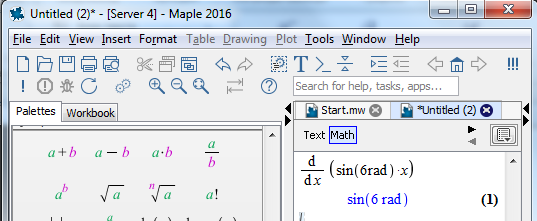

June 23, 2016
I think in Mathcad 11 and Maple all is OK:

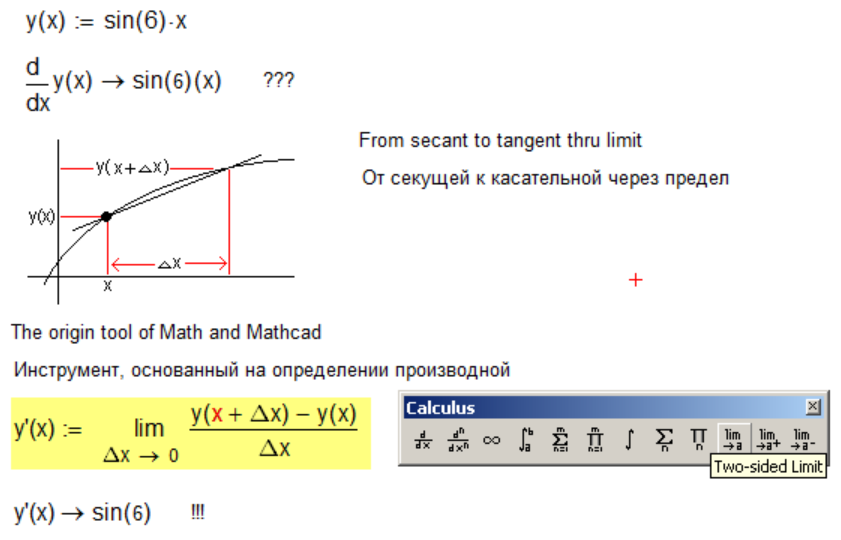

June 23, 2016
My students sometime get so:
Do you know why?

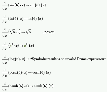

June 23, 2016
Several other functions than sine generate similar results:
/Henning
