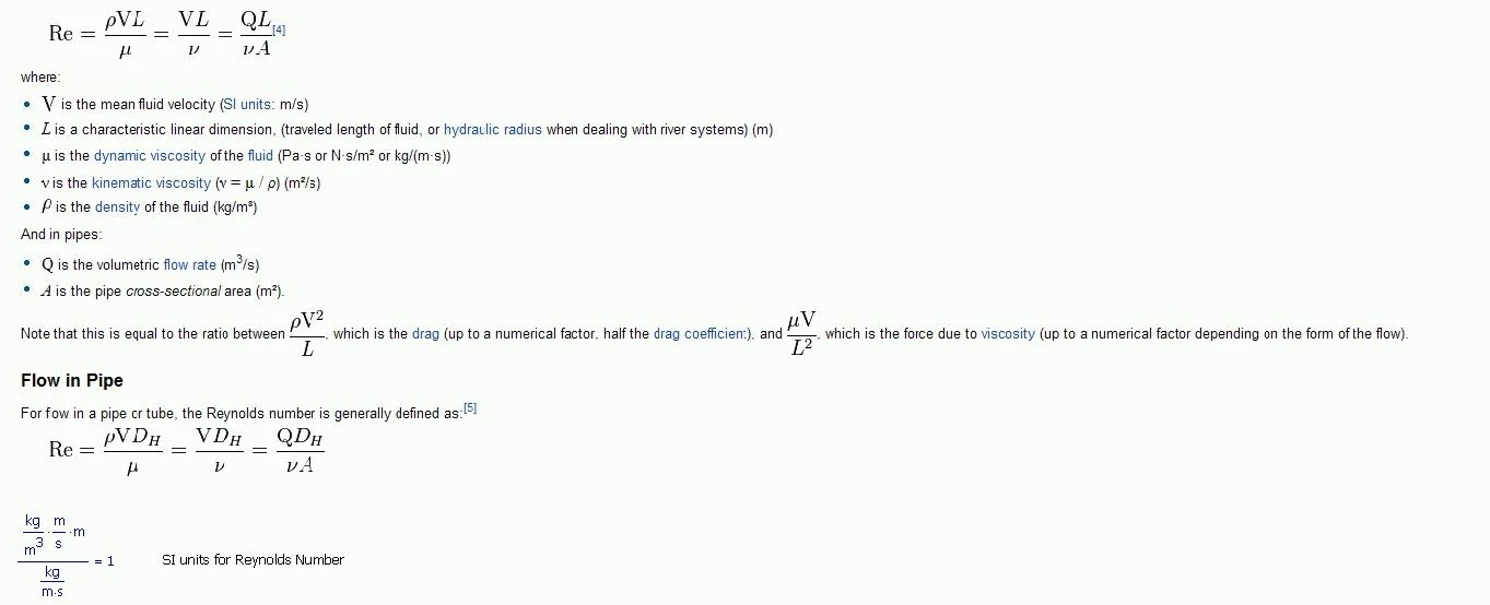

September 22, 2010
Jean,
See attached image.
Mike
September 22, 2010
MIke Armstrong wrote:
Jean,
See attached image.
Mike
Yes Mike, I see the image but it does not cut the mustard.
Re is not calculated so directly in flow metering sizing. DH has not landed on earth yet ? You pass me something so superfluous in my Engineering Discipline that you didn't notice the missing "DH" . The last cross check can't be checked in Mathcad, Mathcad does not have any "Flow rate" unit ! In flow metering, Re depends upon Q and vice versa , Q depends also from other factors depending upon Q . The work is multiple iterative, that's why the Re is not what you give. And that is again my irreversible point "you must know what you are doing", not sure: ask the old wolf. My recollection fails if "MassBal" [used for piping and pump sizing] had units in the mid 80's, we were mostly meeting with more conclusive facts like pipe size and pressure requirements with results hand written.
Jean.

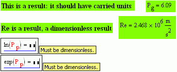

September 23, 2010
Dan,
I will leave this thread with the attached Mathcad QS.
It is sourced and untouched by myself except for :
1. Yellow & green
2. The note below the brown line.
Please read this note carefully. It introduces to
understanding more about designing and using
a unit system, no matter the software, though
it particularizes Mathcad in the context.
It might behave differently in versions above 11.
Don't hesitate for more questions ... etc.
Jean
September 23, 2010
Hi Jean. In your attach (hcvacrat.mcd) the density rho (equal to mass by volume) is defined with units of specific weight (equal to rho times g). The formula for evaluating Reinold's number needs the density, which is an intensive propertie. Correcting the unit lbf by lb in the definition of rho gives the correct result for Re, this is, unitless, or, better say, dimension-less.
Regards. Alvaro.
