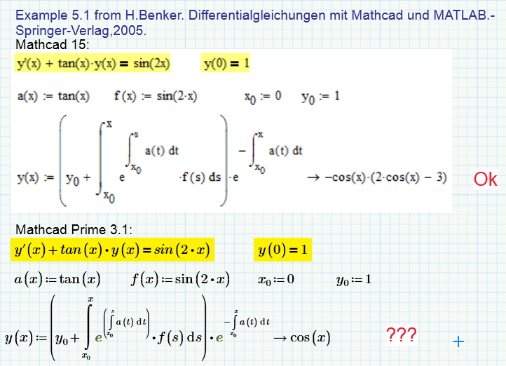

Yet anothing they have broken in Prime.
I have no explanation but the problem seems to be located here:

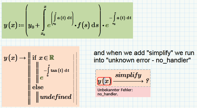

Here's another "nice" effect (symbolic eval not done inline but in a separate region):
