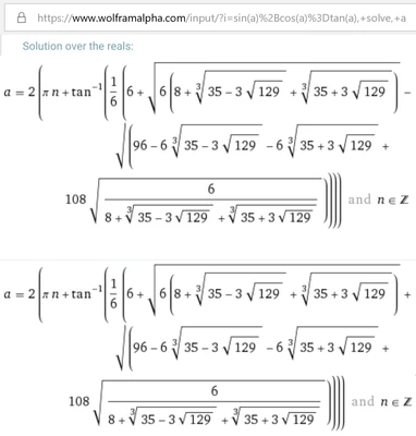

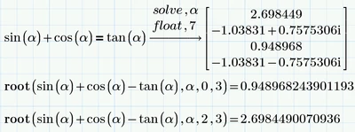

Why not!? Can you show the symbolic solution?
I show to my sdudents the equations sin a + sin a = tan a
99% say that it is not correct? But 1%...
See please

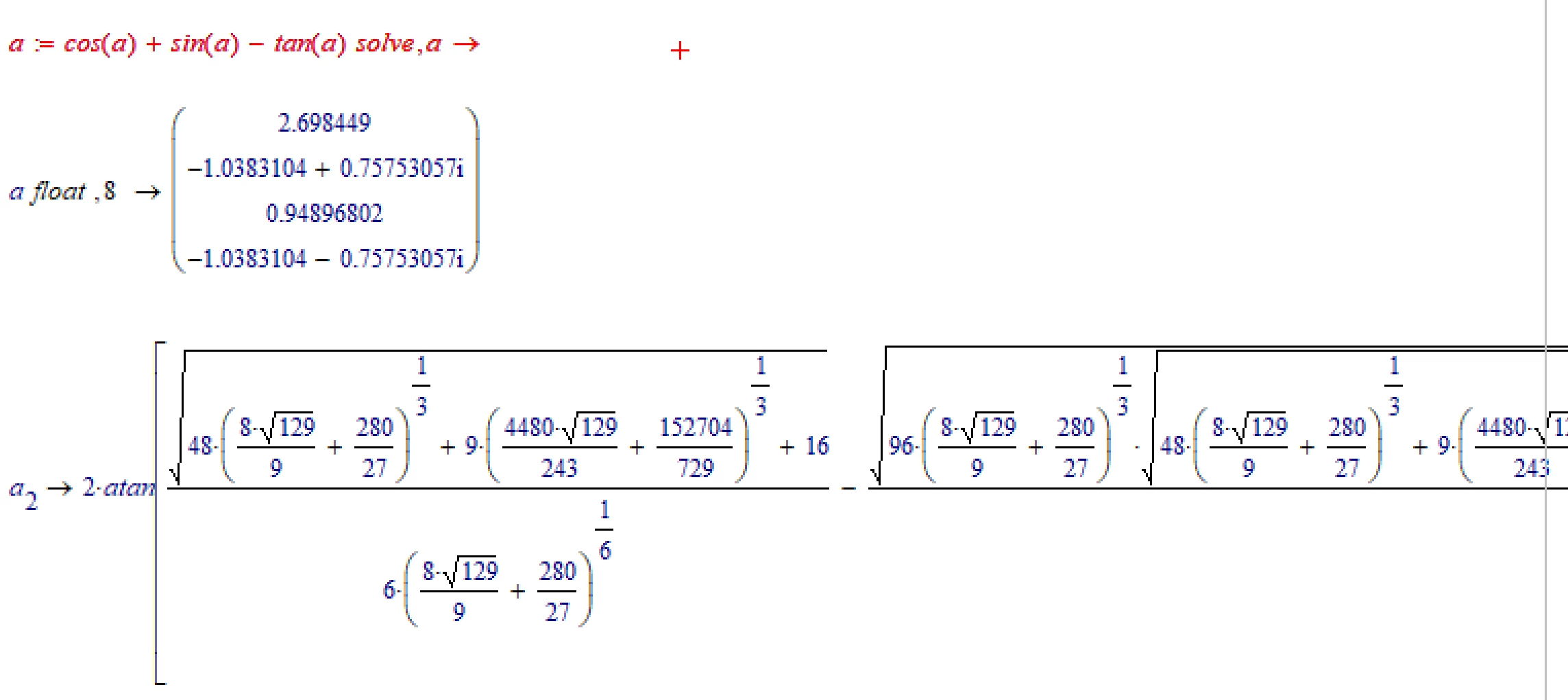

Your text "sin(a)+sin(a)=tan(a)" shows different from you mathcad sheet picture.

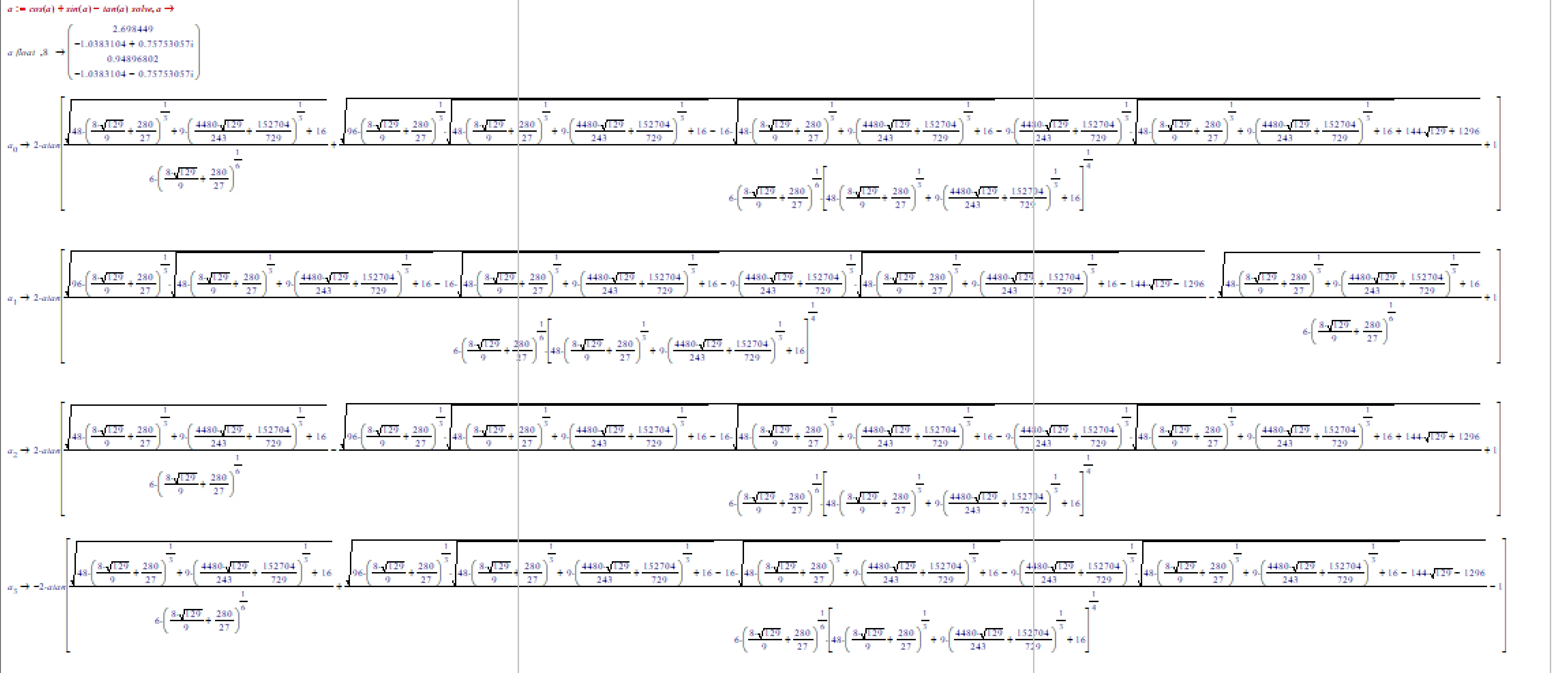

Because it's more intrigueing I tried the latter first:
Note that there are four primary solutions to this problem. (see the float results). I expanded the smallest real solution up to 2 of 5 pages..
I guess the size is the reason why Prime will not give you the symbolic result...?

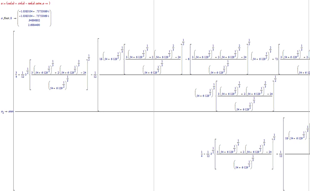

April 28, 2019
In Mathcad 15 all symbolic results are equally wide ("only" three page widths). Using the modifier "simplify,max" the result gets four pages width.
