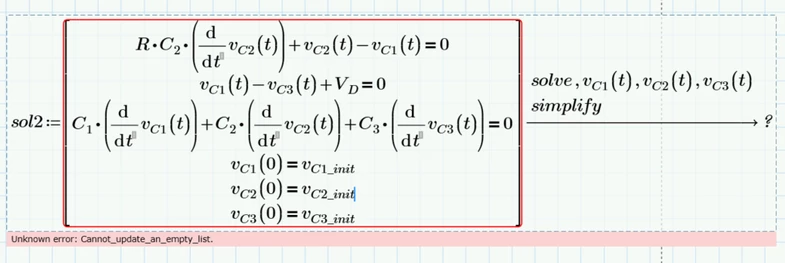

Why solve cannot solve this system of diff eq with 3 eq?
I am making something wrong? Are only 3 differential equations...

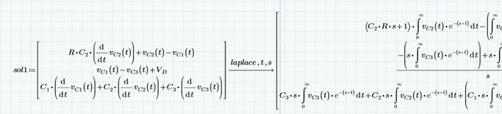

But using laplace command this system of differential eq can be solved:
See MCP9 file attached.

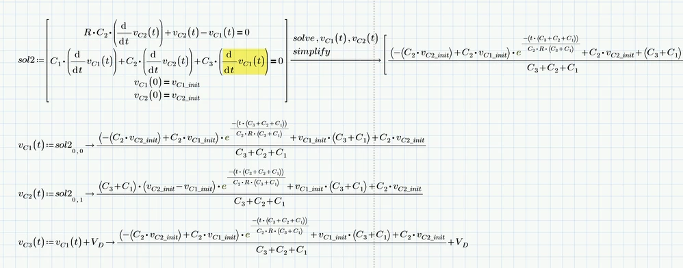

It may be because of the dependency of the three function in equation #2
This works (derivatives of vc1 equals derivative of vc3:
v.C3(0) cannot be chosen freely!

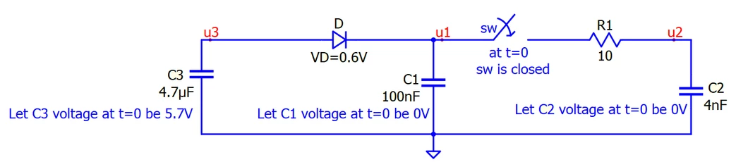

This is the circuit:

The situation of your circuit is impossible.
To the left of the switch, at t=-0 you have a capacitor C3 charged to 5.7 V, in parallel to the series connection of a diode, that you model with a (constant) voltage source of 0.6 V, and a capacitor C1.
This means that the voltage across C1 must be 5.7-0.6=5.1 V, not the 0 V that you set it.
