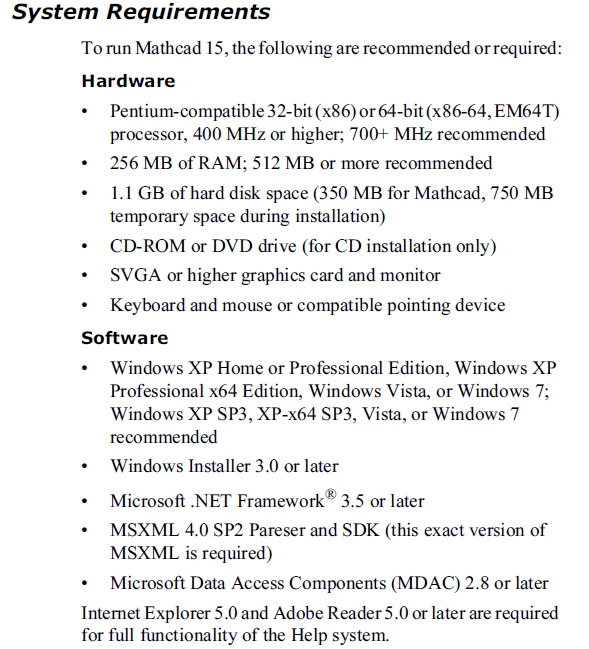

Your worksheet works fine for me in Mathcad 15 M030. To run Mathcad 15, the following Microsoft components are required:
  • Microsoft .NET Framework® 3.5 or later;
  • MSXML 4.0 SP2 Pareser and SDK (this exact version of MSXML is required);
  • Microsoft Data Access Components (MDAC) 2.8 or later.
You can find M030 release by using this links:
http://www.ptc.com/product/mathcad/free-trial
http://www.ptc.com/product/mathcad/free-trial/thank-you
