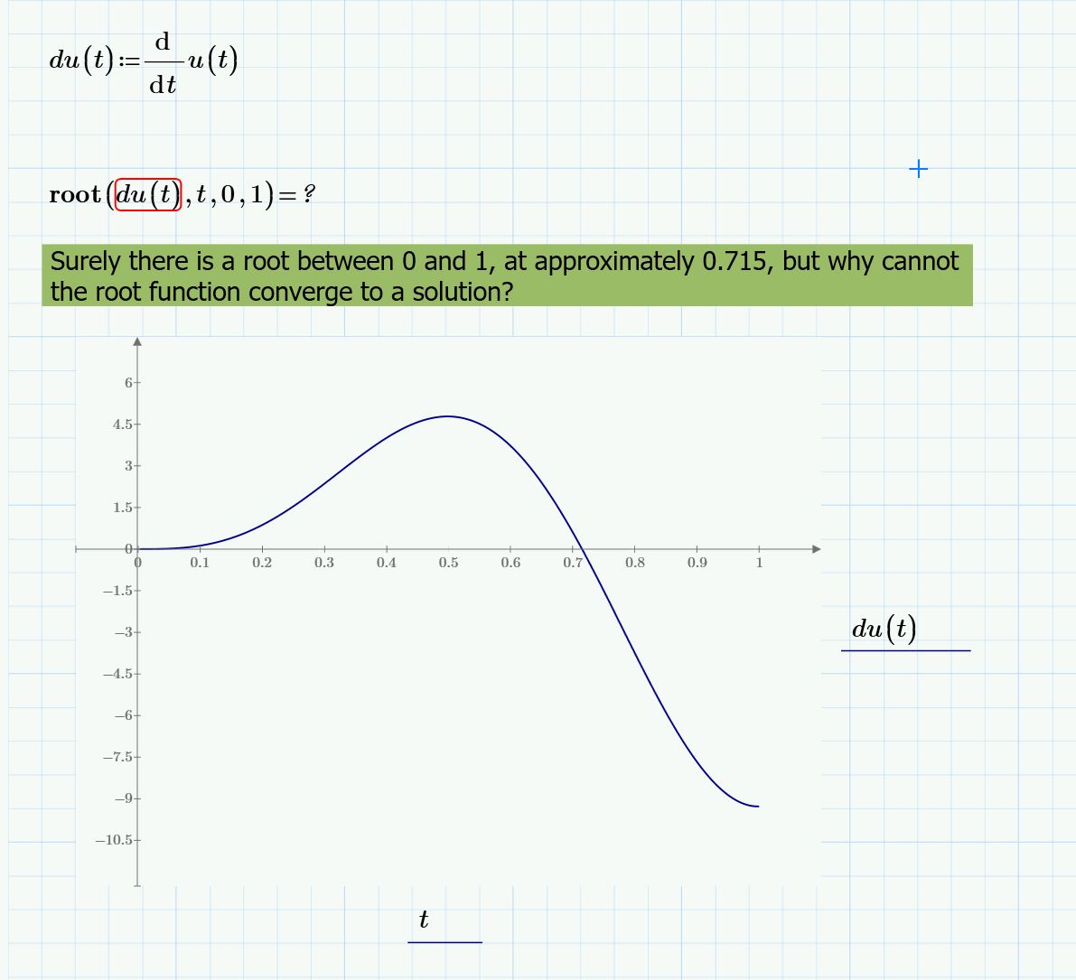

Why the root function cannot converge?
Hi, guys,
Could someone help me with the below problem? Please see the attachment's last page for further details.
Thank you very much!
Shawn

November 2, 2015
Changing the range from  "0" to "1" to  "0.1" to "1" seems to fix the problem.
I hope this helps.
Norm

sfan1-VisitorAuthor
November 2, 2015
Yes, that trick works.
November 2, 2015
I'm not sure I would label it as a "trick". I can't read your worksheet, but I suspect it's more of a valuable lesson in numerical computing. I don't know what the function u(t) is, but I suspect that if you try to evaluate du(0) you will get a divide by zero error.
