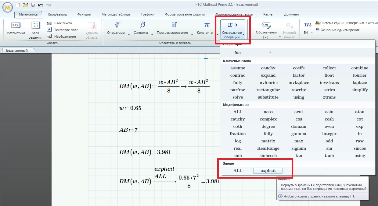

I defined a user-defined function: However the variable after the equal remain undefined.
Already I created similar functions. But, this one is giving me a hard time. Could someone help me please.
MathCAD Prime 4.0
May 30, 2017
Do not use = operatorat the end of a function creating!
23-Emerald I
May 30, 2017
If you define w and AB above your function it will evaluate using those value.  As Val demonstrated, using the function with other values will evaluate with those values.
June 1, 2017
Something like this?
