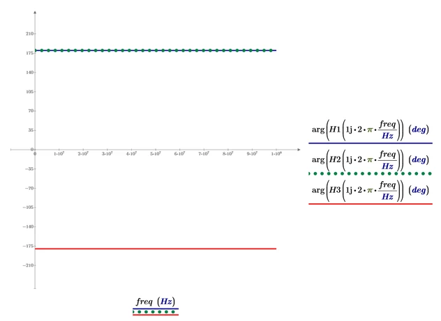

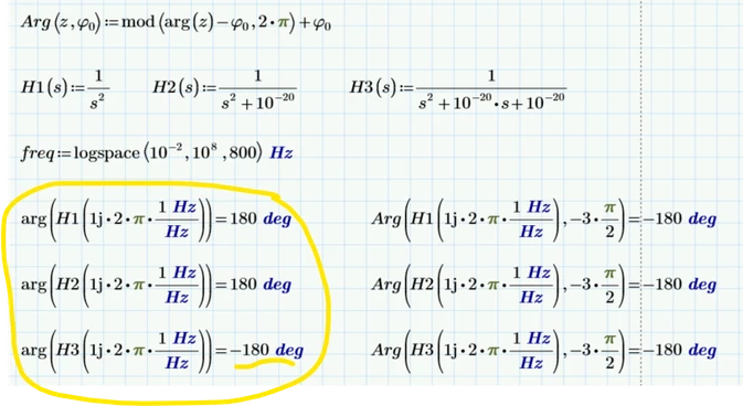

Just check the value
There is a very tiny negative imaginary part and so the phase is -179,999999... deg which for display is rounded to -180 deg.

Probably due to numerical accuracy.
