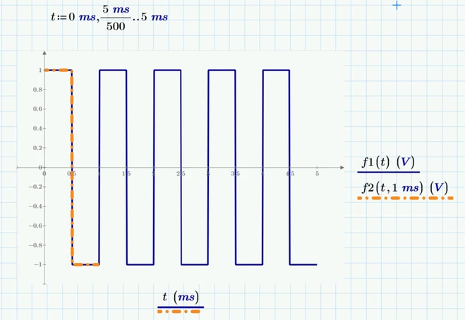

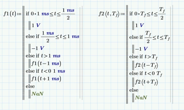

Why these 2 function implementation of square wave does not have the same result when plotting?
Why when plotting f2(t, Tf) does not look like f1(t)? The two functions are the same...

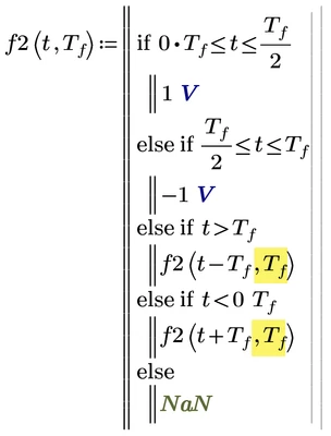

And the only solution for this is this (to define Tf above f2)?
NO!!
You simply have to use your function the way you had defined it - with two arguments!
As i already wrote, you were missing the second argument when you called your own function.

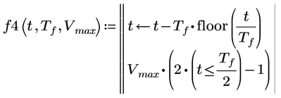

Here a an alternative function
Calling the "mod" function twice is necessary to deal correctly with negative t-values because the implemented "mod" function would return negative values for negative arguments.
Another alternative:
could also written as
No, they aren't the same. When you CALL f2 from within f2 you are missing the second function argument!

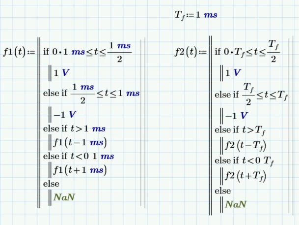

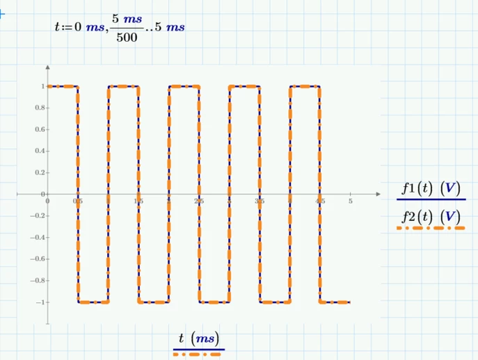

Cornel19-TanzaniteAuthor
Werner_E25-Diamond IAnswer
NO!!
