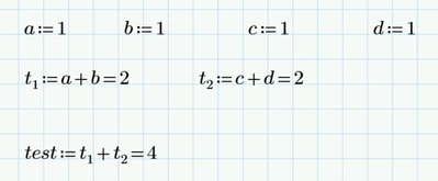

Why variable result is not updated in this scenario?

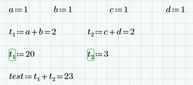

Then I overwritten values for t1 and t2 and test variable result was updated with the new values of t1 and t2:

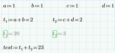

Then I disabled t1 and t2, but the test variable remained unchanged. Why t1 and t2 did not took value 2 and update the test variable result with 4?
Because Prime is buggy!

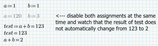

I can confirm that I experience the same faulty behaviour (Prime 11, with auto calculation turned on).
Only after an explicit recalculation of the sheet (Ctrl-F5) the result updates correctly.
For the bug to show up its necessary to disable both variables at the same time!
As we can see the variables a and b actually are updated correctly, its the assignment of variable test which is not updated.
Feel free to report this bug to official PTC support. Good luck!

Beside Prime 11, I tested this situation also in Prime 9 and Prime 10.0.1 and the same behavior is happening also in these latter two versions...
Jan 21, 2026 3:35 PM UTC
Yes, it seems to be a rather old bug.
I traced it back to Prime 5.
In Prime 4, the behavior is still OK as it should be.
You can mention this if you decide to report the bug officially.
