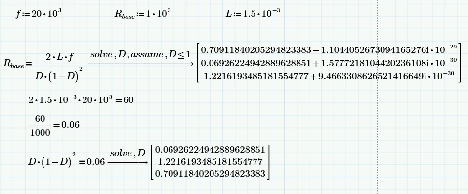

Might you know how I can clean up my return values for the solve statement? I can't seem to get "assume = real" to work. Or "D < 1" to work either 😞
What am I missing (besides your most timely and heroic help)?
May 24, 2019
Reduce the equation by performing the arithmetic you can do.  Then solve.  You get real values.
