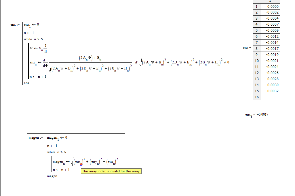

Hi, for some odd reason Mathcad 15 is not pulling from the "enx array" despite that array having values in these indicies.  Is it because the derivative? Anyway I can fix this?

You should post the worksheet, if possible.
July 22, 2016
It has nothing to do with the derivative.
It's hard to debug a picture, so please post a worksheet. Making a wild guess, what is the value of N, and how many rows does enx have?

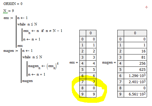

What happens if the condition:
is not met?
If it is in any case from 0 to N-1 then the individual element will default to a 0 result:
If , however , it is the last element, then the array will be 1 entry short:
As the next calculation is looking for enx[N which does not exist, Mathcad reports an error.
Regards
Andy
