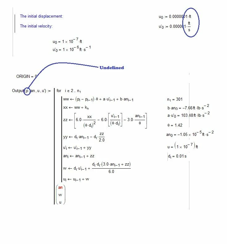

Attached is a copy of Mathcad 15 file that I'm working on. I'm trying to convert a Matlab code into Mathcad file, I have done some work on the worksheet, but I ran into problem in converting Matlab programming into Mathcad programming. The Matlab code is at end of the worksheet. Would anybody please help me with the worksheet, my goal is to plot the time history of displacement, velocity and acceleration. Thank you in advance.

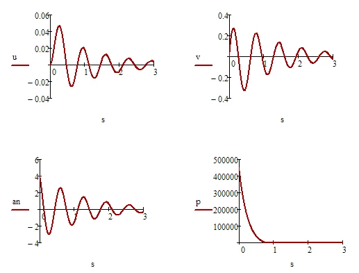

Werner_EAnswer
Oh yes, you are right! That was pretty tricky with the brackets 😉
Now Mathcad delivers at least the correct results (unitless as in Matlab).

as you see from the following picture, the variable p is undefined. Furthermore are missing some unit of measure.
Regards
FM
