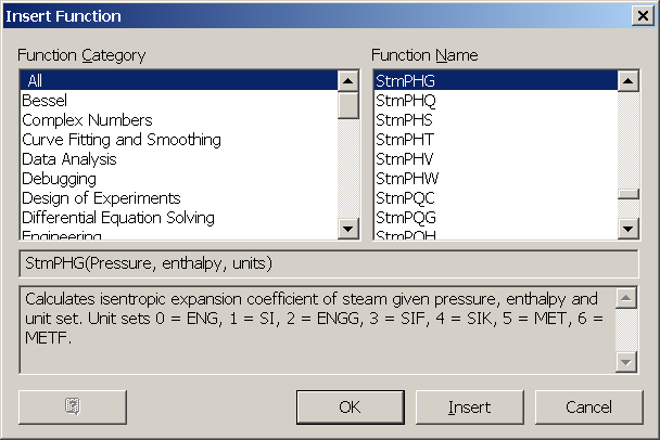

I am a new user of MathCad.
I want to use WinSteam (a steam properties programme, developed by Techware) functions from within MathCad. During installation, WinSteam creates a DLL file and I can see that MathCad understands the functions attributes and parameters correctly when I type in correct syntax. My question is how do I get those functions listed in Functions (either as User defined or some other category) so that I can scroll and select them from a list.
Typically Winsteam functions look like, for example, StmPQM(p,q,unit system) for dynamic viscosity at a given pressure (p) and drynes fraction (q). Remembering exact syntax, letter cases for all functions will be a struggle. Would be much easier if they appeared on screen (like they do in Excel and supposed to be same in MathCad).
cheers,
Sanjay

Hello Sanjay,
Did you you find a way to make the winsteam functions appear in mathcad?
I'm having the same problem with Mathcad 15.
Stephane
July 15, 2013
To make the functions appear in the insert functions list you will have to edit the file "user_EN.xml" (located in ....\Mathcad 15\doc\funcdoc) appropriatly. Further details are found if you click "Help/Developer's Reference/Writing Mathcad DLLs/Creating help for your functions".
In fact you don't have to use the "user_EN_xml" but you may chose to create a new xml-file with a different name. Thats OK as long as its placed in the correct directory and named with an "_EN" (or "_DE" or whatever language code) at the and.
So either the makers of your addon pack provide that XML-information or you will have to do it on your own.
July 15, 2013
Guys, in the installation folder is a file with the descriptions of functions: McadFunc.txt
