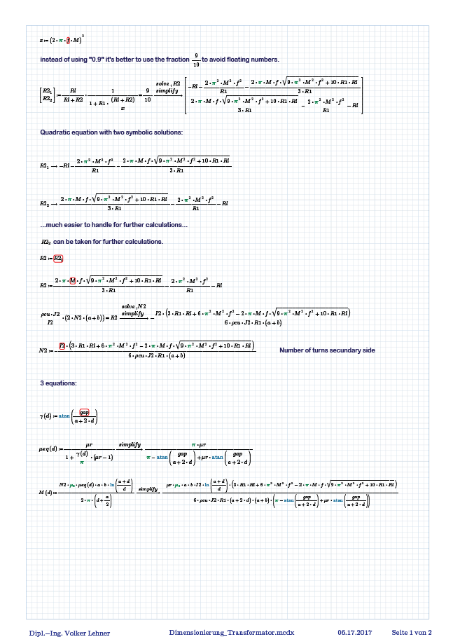

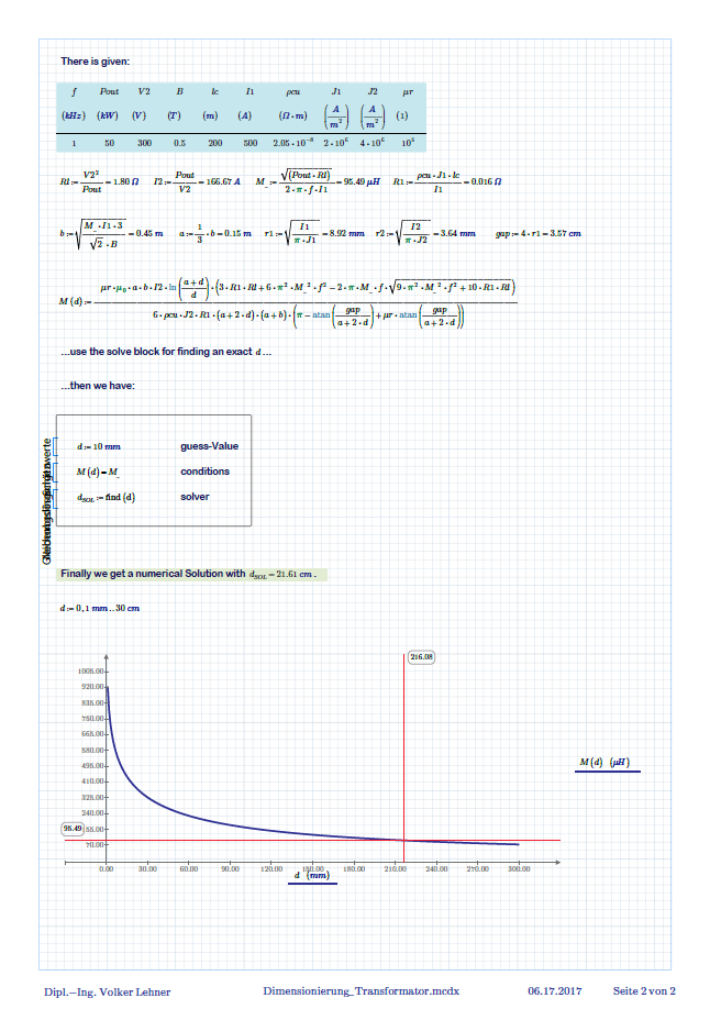

Hi Ahmad,
MathCad can be indeed a powerful instrument.
We can find an exact solution for the coil diameter.
A tipp for you:A symbolic evaluation here is better for calculating the resistance R2 as following:
Unfortunately i can't attach the files here.
Best regards and Welcome here,
Volker
ps.: I'm working with MP4.0
have fun!
