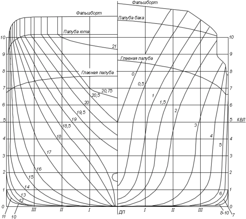

I am looking at defining a 3D shape (the underwater profile of a ship) and then being able to evaluate the shape i.e. what is its volume, where is its centroid, calculate moments about its centreline etc.
The shape I have in mind can be defined in one of two ways but in both a number of 'slices' of the ship's profile are defined usually in terms of x,y,z ordinates to give a number of 2D profiles either working from front to back or from top to bottom. I know that I could plot each 2D 'slice' in MC and could then evaluate using integration but is it possible to 'put these together' and evaluate the 3D shape in a similar method?
Or is there a better software out there for this? I thought of 3D CAD type softwares but don't know if these have the mathmatical caability of MC (It has been years since I have used CAD software but don't mind getting back into it).
Any thoughts or advice warmly welcomed.
A
PS to give a visual idea of what I am working with below is a google image of the sort of thing where by a number of vertical 'stations' are defined for a ship and I would need to essentially integrate them all to give a volumetric property.

How to intergrate along the vessel to get total volume.
Input is the station distances as x ordinates.
Input is the station bouyancy areas as y ordinates.
Integration is total volume.
Trick is to put a smooth spline through the points.
You can then integrate the interpolation of the spline.

This is a Mathcad 14 file.  It calculates the bouyancy volume and longitudinal centre of gravity of a real ship at given draft of 3.8m.
I did it to check the results of Delf ship free software.  The Mathcad results are the same.
The file reads a DXF file that has been exported from Delf ship.  The DXF file are the vertical stations of a vessel hull 31 of them at 2 m apart for the 62 m long vessel.  DXF files are single lines of text and can be read and interpreted by MathCad.   The calculations are made a bit more complex as some of the station lines start at keel and go to deck, while some start at the deck and go to keel.  Splines are used through DXF points to perform intergrations.
The Mathcad reads the DXF file to obtain cordinates of the hull for the calculations.  A jpg of the DXF shows the stations and the hull.
Delf is far simpler to use and produces the same results.
