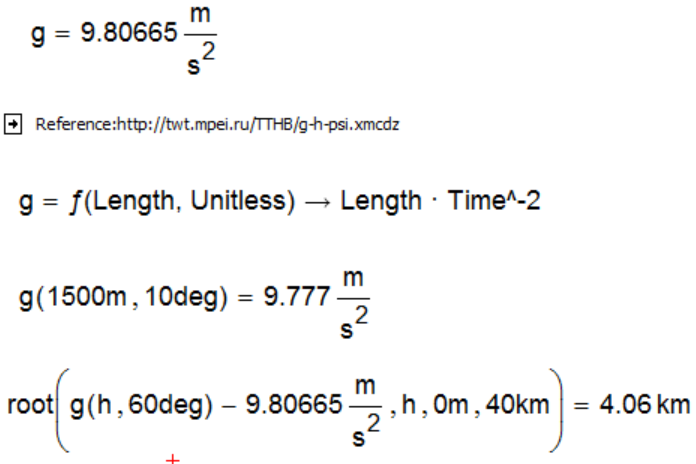

I want to have in Mathcad not constant g (acceleration of free fall), but a function of h and latitude. I make reference to cloud Mathcad-sheet on the address http://twt.mpei.ru/TTHB/g-h-psi.xmcdz and have this function

What could be the reasons that my file, when referencing another file, doesn't seem to do anything via the reference?
thanks in advance,
Hussein
January 22, 2016
I just noticed the file is in the link.
