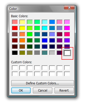

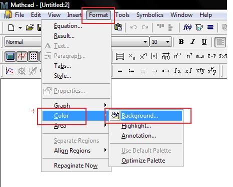

Check your color background (in main menu go to "Format" -> "Color" -> "Background"):
April 17, 2012
I tried editing the Normal template but the background color was already set to #fff which is white. I also tried changing the background color via "Format" --> "Color" --> "Background" but it was also set to white. Any other ideas?
