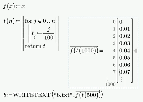

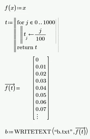

simply delete the vector index j in WRITETEXT. Depending on the nature of your function f it might be necessary to apply vectorization. In case of your simple identity function f(x):=x it would not be necessary, but I would always apply vectorization in such situations.
As you can see there is no need for any range variable.

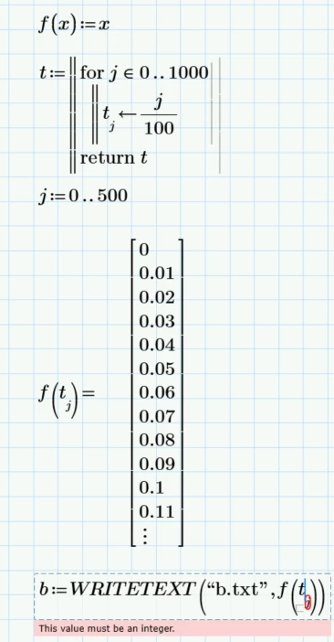

What you did is a misuse of a range variable. A range variable is an implicit loop, kind of programming.
f(t[j) is an invalid object - you can see this when you try to assign it a variable using F:=f(t[j). You will get an error message doing so.
Of course you could write F[j := f(t[j) and this would work OK because now the range j is used for one of its three use cases, indexing a vector/matrix.

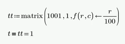

BTW, here is an alternative to create a vector like t
