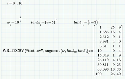

Hi, I am a user, sometimes occasional but now more continuous, of MATHCAD various releases from more than 20 years now. I have always problems in finding a simple way to produce a data file starting from the quantities I define in my programs.
As an example, I wrote a quite simple program using PRIME 4.0 to plot a quantity as a function of another (a magnetic loss vs frequency) using a bias magnetic field as an external loop. So far, z=z(x,y) where both x and y are changed in a loop with x=x1, x1+xstep, ..x2 and the same for y.
At the end I was able to plot z=z(x,yfixed), with several curves depending on the yfixed value, but if I want to export this quantity in a ascii file I am in trouble, because the explanations in the help are not easy to be followed. In particular, I need to produce a file where the first column is the frequency, and all the others are the z-values with different values for y (which I fix when plotting)
In the attached MATHCAD file, the table (file) I want to fill in is that composed by omega and by all the tandelta values depending on the magnetic field Ho.
Do you know any example I can use downloading it?
Thank you very much.

Here's an example that should get you going:
Prime4 file attached.

I will try now to put your code in my program after transforming it to produce a real matrix with i,j-indexes. I am user since a lot of time, but every time a quite simple requirement like this is a bit troublesome in MATHCAD. Actually, to have data files corresponds to the requirement to obtain not only data for post processing but even for better plots for publications.

Luc's same idea, but with an i,j example.

As I understood from your reply, I tried to mix two different possibilities in MATHCAD, and for this reason I was not successful.
Because of my previous background and experience, I preferred to define "functions" like z(x,y) to obtain also data to be written in a file. Now, I realized that to define a function is useful for plotting data directly in MATHCAD, but it is not so effective for obtaining correctly a matrix to be exported as a data file, where there should be a dependence on i,j-indexes and not on variables used for defining a loop.
I will re-write the program following your suggestions, avoiding to mix concepts and definitions that cannot work together.

I ended the program successfully, writing it, as I told you, in a new way, with i,j-indexes and not using the function z(x,y), which is indeed more useful for plots.
Attached the final file, for everyone needing a routine for calculating the magnetic permeability tensor in magnetic material computations with PRIME 4.0.
