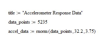

OK I see that and indeed it works. But a couple of questions come to mind. I would have thought the written file (in this case WriteStrings.txt) would not be human readable. What I mean is when I open the file with text editor I expected to see gibberish but yet the text is perfectly readable. Clearly I don't understand what WRITEBIN does.
The next question is what if my output file needs to have text and numbers. For instance I have a title row, followed by the number of data points in the file followed by the data.
How do I build a vector of mixed data types to write to a binary file?
