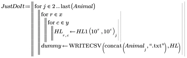

Werner_EAnswer
Jun 3, 2024 6:25 PM UTC
See if this does the job

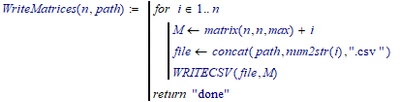

This little program
Creates n files: The line
M<-matrix...
Creates an n by n matrix with sequential numbers in the rows and columns starting at i
The line
fil <- concat....
Creates a filename containing the number i
And the line
WRITECSV...
Writes out the matrix to the file
Called with:
ït creates 3 matrices, the first contains:
1,2,3
2,2,3
3,3,3
The second contains:
2,3,4
3,3,4
4,4,4
And the third contains:
3,4,5
4,4,5
5,5,5

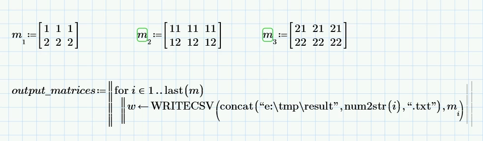

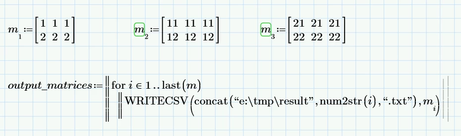

Werner_E25-Diamond IAnswer
