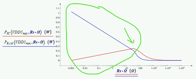

my Company forces me to switch from MathCAD15 to prime 10. Despite many other item I have question about logarithmic plots:
How can I set that the break points for calculation are also done on a logarithmic base?
It seems that the brake points still have linear steps --> almost no resolution on the low value end - even when setting "Number of Points" to 3000.

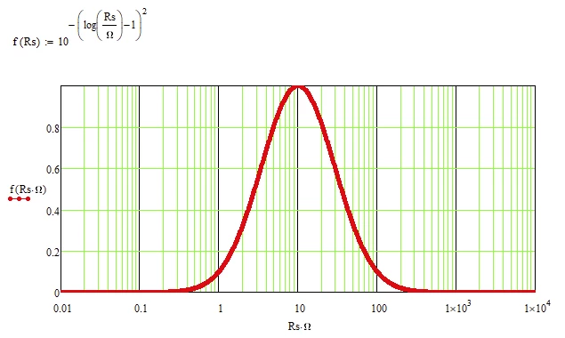

I can confirm that in Prime the quickplot feature (plotting without defining the abscissa variable) with a logarithmic ordinate axis is broken.
As you already suspected, the values still are spaced linear which is unusable.
Mathcad 15:
The same in Prime 10 (using the default 500 points):

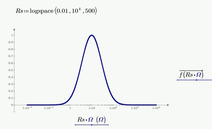

A possible way around this bug could be to define the ordinate values as a vector with logarithmically spaced values created with "logspace".
Here again using 500 points:
Vectorization (the arrow over the expression) is not mandatory in case of the function f used here but may be needed for other functions. So I consider it a good idea to use explicit vectorization every time you feed a vector as argument in a function written for scalar arguments.

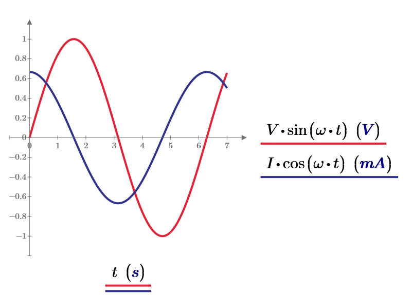

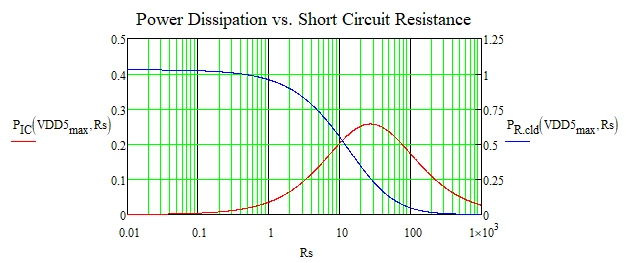

BTW, I notice that the picture of the MC15 plot you attached showed a plot using a secondary y-axis. Primes native plots do not provide a secondary y-axis (and no labels and no grid lines ...). PTC therefore, instead of improving the native plots, had integrated a third party tool ("Chart component") which has a second y-axis, labels, gridlines, but also its own drawbacks - apart from being really slow it does not know anything about units. If the secondary y-axis is mandatory you would have to use that Chart component to create the plot.

If each plot has different unit, you can plot all in one plot.
