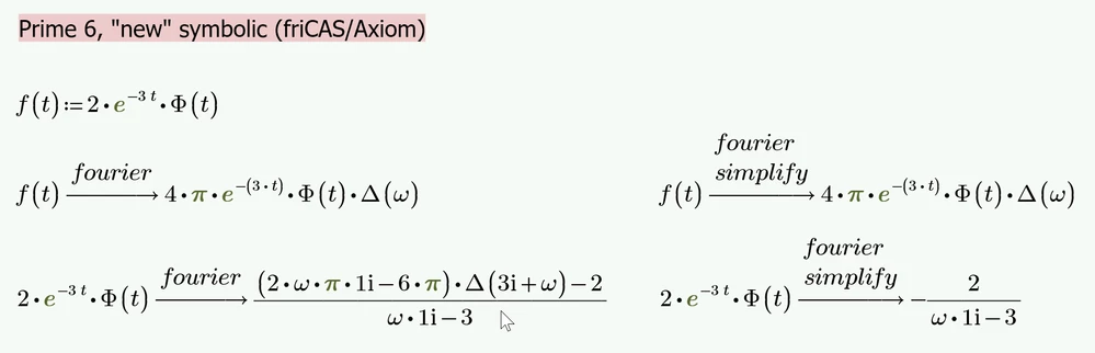

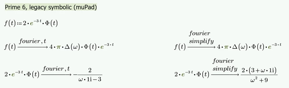

Wrong result for keyword fourier transform?
Input:
where
is the step function:
Rewriting the above result:
And calculating fourier transform by definition for the above input, results:
So, where is the mistake?
The 2 above results should not have been equal?
Mathcad Prime 8 file attached.

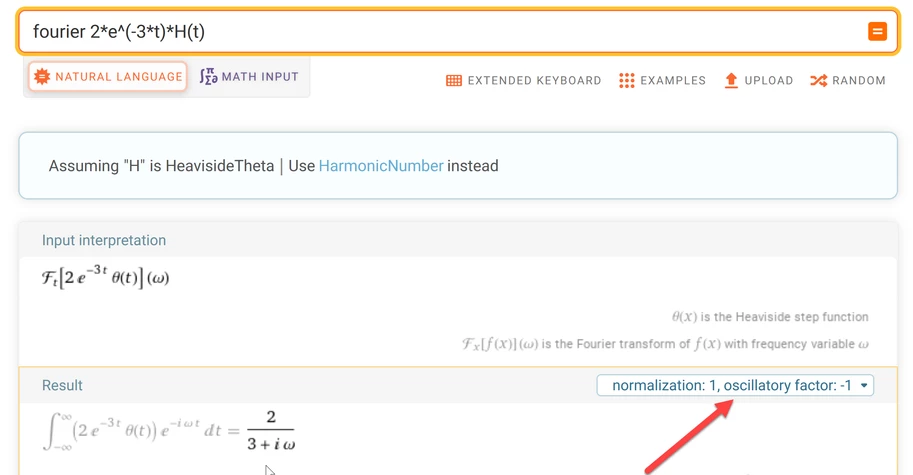

@Werner_E @-MFra- @ttokoro

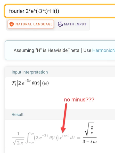

I think I discovered where the difference comes from:
So, fourier transform in keyboard has this definition for calculation of fourier transform:
and not
The difference comes from that - sign, as Werner points out in Wolfram Alpha.
Is this definition used by fourier transform from keyword correct?
From what I know the fourier transform is defined in this way:
So, including that - sign.

23-Emerald V
Apr 19, 2023 2:06 PM UTC
The mistake is in Prime.

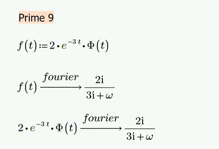

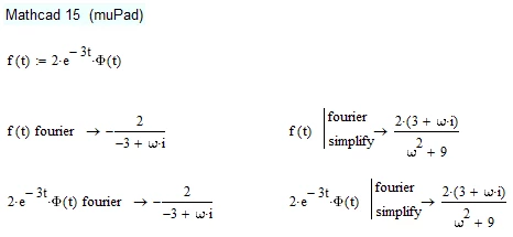

If Mathcad 11 may be the judge:
Chances are this bug has been solved in Prime 9, otherwise/anyway you can/should report this bug to PTC.
P.S. this is what Prime 7 produces:
Apr 19, 2023 2:55 PM UTC
Prime is a work in (sloooow) progress - maybe some day it will get it right.
Once more its clear - when it comes to symbolic math, Mathcad 11 with Maple rules!
Apr 19, 2023 3:19 PM UTC
BTW, here is Wolfram Alpha
EDIT:
Ahh! Got it!
I was aware of different scaling/normalization in the definitions of the fourier transform, but not of something like this "oscillatory factor"!
As far as I could see there is no definition of the fourier transform mentioned in the Mathcad and Prime help.
Different "oscillatory factors" may be an explanation for Primes results !?
Apr 19, 2023 3:20 PM UTC
A few years ago a list of all the "defective" calculations of MATHCAD 15 was published in the MATHCAD community. In Prime some have been corrected, but I see that others remain...
