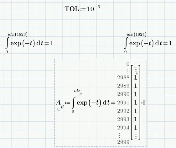

I have been updating a Mathcad sheet and noticed that there are slight discrepancies in the results on the order of 1e-6. I tracked the source of this error and I got to this integral (shown below).
There are two things I do not understand:
1.- Function A and B are the same but for some reason B throws an error "this value must be an integer".
2.- The integral should be equal to 1 when the upper limit is approx higher than 5. But for some reason the solution jumps from 1 to 5e-4 when the upper limit goes from 1.011e4 to 1.013e4, which is wrong. It should be 1.

ad 1.)  You used the literal index when you typed B.ii but you should have used the matrix/vector index as you did in A[ii.
ad 2.) Numerical math approx algorithms always are good for strange effects. You can cope with that problem by decreasing the value of the system variable TOL from its default value 10^-3 to something like 10^-6
I won't call this a bug, its simply a a natural side effect of the algorithm used for numerical integration.
If its just this simple integral, I would suggest to replace it by the exact expression 1-e^-t.

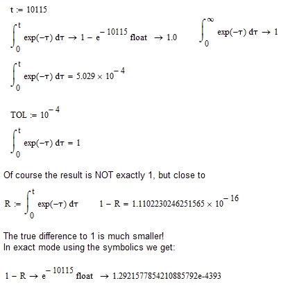

We experience the same effect in real Mathcad when using the default tolerance setting of 10^-3. Here a screenshot of Mathcad 15:

Prime 10 also has this bug.

That was it! Thank you for your response, Extremely helpful.
Unfortunately, the integral is part of a bigger one and I cant replace with its exact expression. But changing TOL helps a lot.
OK, but keep in mind that the default value 10^-3 normally is well chosen. Setting TOL at a value too small may result in some numerical calculations like integrals, solve blocks, etc.  failing because "the calculation does not converge to a solution". So handle with care 😉
