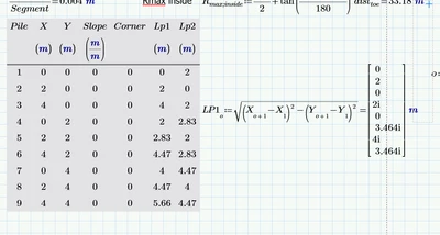

I'm trying to calculate the distance when I do it manually I get different results from the one mathcad gives
Lp1 should be the same of LP1

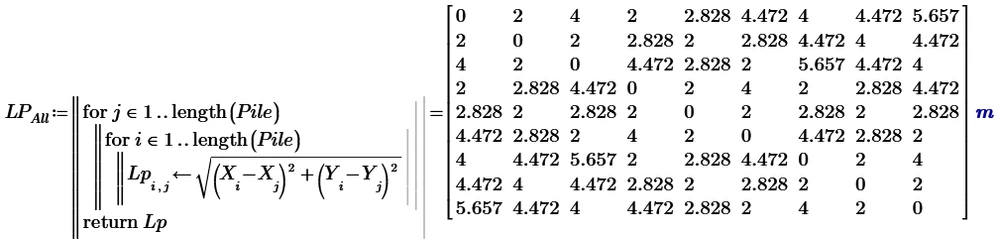

I also need to write a program to make this function uses different fixed point , for example the first time it will use X1,Y1 (0,0) as fixed point and I get the values for Lp1
the second time it uses x2,y2(2,0) as fixed point and I get the values for Lp2
and repeat the process with the all points to get lp3, lp4 ... and so on

I did the same still error occurs , can you attach the sheet, please?

(x-xi)^2 + (y-yi)^2  plus not -.
