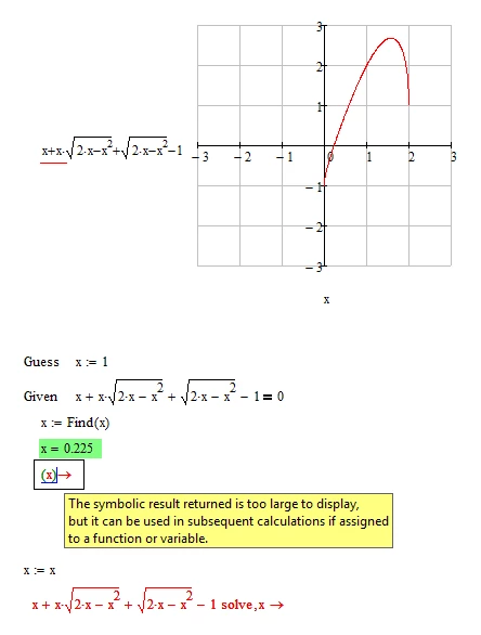

x + x*(2*x - x^2)^(1/2) + (2*x - x^2)^(1/2) - 1 solve , x ----> ? (Symbolic Evaluate)
Hello Everyone.
From :
To :
       Symbolic Evaluate ? ( MC 15 )
Thanks in advance.
Regards.

This happens (more often) in MC15 as well that f(x) can't be simplified to 0 or a certain value c we know the expression should simplify to.
Also f(x)-c usually won't simplify to zero but most of the time the symbolics is able to simplify the Boolean expression f(x)=c to 1. Not sure why.

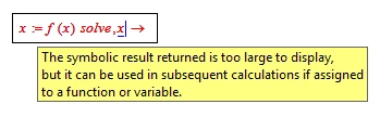

May 1, 2025 5:14 PM UTC
Here you are, sure very informative and useful 🙂
BTW, the symbolics in Prime 10 doesn't even try to get an exact symbolic solution

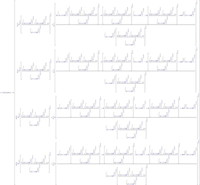

Ah, no problem in Mathcad 11 (NOT Prime 11). Here are the four solutions:
Their numerical values are:

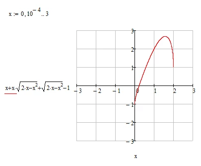

My MC15 say :
and I don't understand the solution of 1.947 ( see my graph below )
Thanks any way, Luc.😊

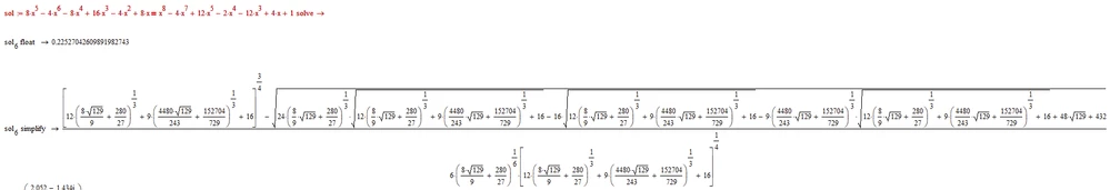

May 1, 2025 7:40 PM UTC
Maple in MC11 seems to be internally squaring the equation and so comes up with four solutions - similar to my modified appraoch here:
Re: x + x*(2*x - x^2)^(1/2) + (2*x - x^2)^... - PTC Community
Unfortunately, MC11 does not remove the invalid dummy solutions. See my reply to Luc below which shows where the 1.947 stems from.

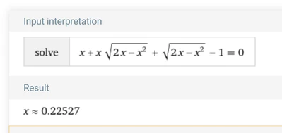

By the way, Uncle Wolfram is also content with a numerical approximation only ...
