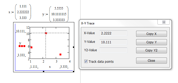

I have a question about the x-y trace function in MC15
When you select a point, the trace box only displays the co-ords to 5 sig figs - if you "Copy x" or "copy Y" you don't get any more precision, and it is not enough to uniquely identify a point when you have a Monte Carlo analysis with 10^6 points. Is there any way I can increase the resolution? The little example below illustrates my point
7 replies
Mar 15, 2015 9:26 PM UTC
Unfortunately, 5 significant figures is what you get.

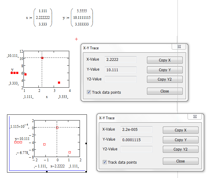

You could try something like subtracting the displayed trace values from everything and plotting the result. The new trace should show the next 5 significant figures.:
Alan.

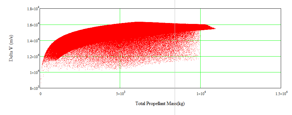

Ok - lets put the question around a different way. I have a plot with 10^6 points on it, example below. The array used to plot it contains more columns. I want to be able to pick a point and find it in the array and then view other columns. I tried using the "match" function but because TRACE doesn't give me enough sig figs it fails to locate the values.
Any ideas how to select a point on the plot and find it in an array
Mar 16, 2015 2:37 PM UTC
You could start by homing in on the region of interest. Alter the start and end of the range on each axis (do this directly on the graph). Repeat until you are just viewing a few points. Apply the process I noted above to the data in the columns that are plotted. Then use "match".
Do you have to do the point selection by hand? What criteria is the selected point based on?
