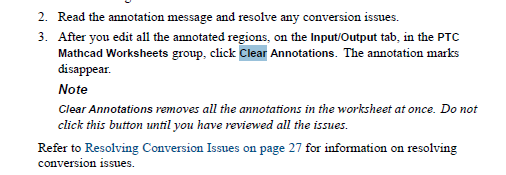

Recently I've converted some my Mathcad 14 worksheets for use in Prime 3.1 using PTC's converter. The converter seems to work well be leaves lots of red arrows and red margin marks. How can this marks be removed from the final sheet? I can't seem to click on them.

From the Migration Guide:
Apr 9, 2015 10:57 PM UTC
dsochor1-VisitorAuthor
Apr 9, 2015 11:01 PM UTC
Thank you very much!
