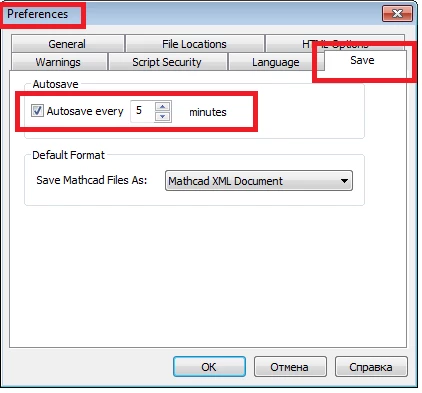

For the future - do not forget about the "Autosave" option (in main menu select "Tools" -> "Preferences" -> "Save"):
