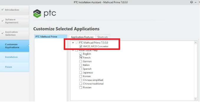

Why don't you do it yourself. If you have (a fully licensed version of) Prime 8, you should be able to.
In case the conversion option is greyed out in the menu for you, you probably forgot to tick that option in the installation. It's unticked by default, nobody knows why....
If this is your case, simple re-install the program, and tick that box along the way.
But anyway, see attached.
Aug 5, 2023 2:10 AM UTC
I tried to but it's showing an error that I don't have mathcad 15 Installed.
