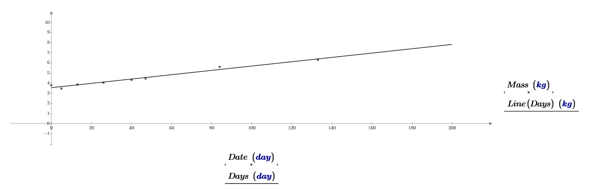

I a trying to get to grips with the graphing capability of Mathcad.
In the attached I have used a polyfit which obviously is not what I want (I am not sure how to use other graphing functions).
How can I get a line of best fit approach?

Ah! I have not read the text thoroughly enough and did not read that a regression line is searched for.
You can also use "polyfit" for that case:
And in case you need the coefficients, you may use "polfitc":
or the built-in "line" command:

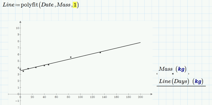

23-Emerald V
May 3, 2017
Instead of:
Try these:
Then:
