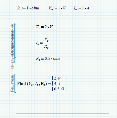

Hi, I'm trying to practice using the Find function, and using a workaround with units.
Pls. see attached. The units are working but the answer it found is wrong. "Io" is supposed to be 4.

And what about the solutions without units in Mathcad 15, suit you?

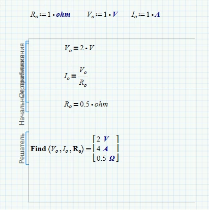

And here is solution with units in Mathcad Prime 3.1:

Can't explain why , but I can add more confusion :
The attached seems to work.

Some more fun:
1) Change the guess from 1V to 1 kV and watch the solution
2) Change the guess back to 1 V and change the V in Find() to kV and watch Io
3) Don't change the kV and replace the "ohm" in Find() by the upper case greek letter Omega (W followed by Crtr-G) and watch Io to change to 4

Changing ohm to capital omega makes no difference when I try it (MC15 M030).
Mar 26, 2015 9:26 AM UTC
The same result in F000 and M030 service releases.
