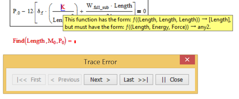

New MathCAD user here. I have spent the last day going through other solve block issues and see if someone else made a similar mistake as myself, to no avail.
I am trying to solve a 3 variable system of equations with solve block and get and error. Any guidance is appreciated

The problem is the equal sign after Find.
Find returns a vector and your three solved for variables have different units (more precisely: dimensions). Mathcad 15 and below has static unit checking and does not allow for a matrix consisting of elements with different dimensions.
This limitation is not present in Prime, as Valery has shown. While Prime has many (and I mean really many!) drawbacks and is not one but quite a lot of steps backward in evolution, this sure is one of the very few improvements made. Not that it would be a reason to switch from MC15 to Prime, but fair is fair, its an improvement.
There is an easy solution to your problem, though. While you cannot evaluate(=) Find, as this would force MC to display a vector with different units, you can assign the result of Find to variables which you put into a vector and display each one separately (and of course you have to delete the evaluation equal sign after Find):
BTW,  you don't have to use the same variable names when assigning.

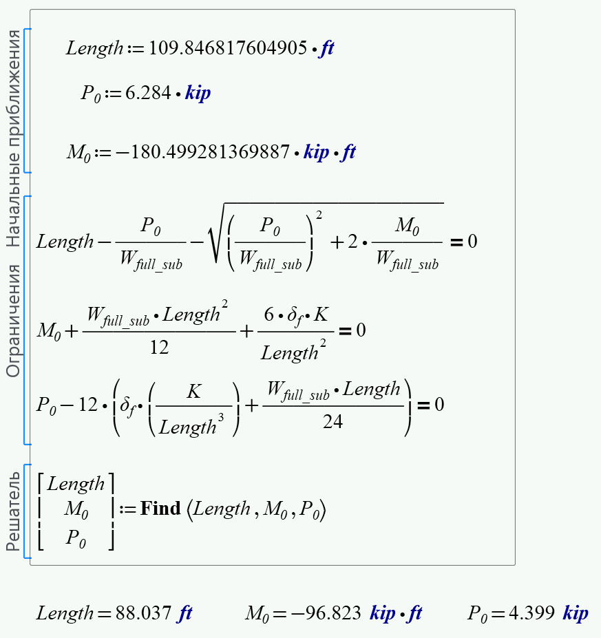

May be problems with units in solve block Mathcad 15.
All ok in Prime:

Aug 27, 2015 9:42 PM UTC
