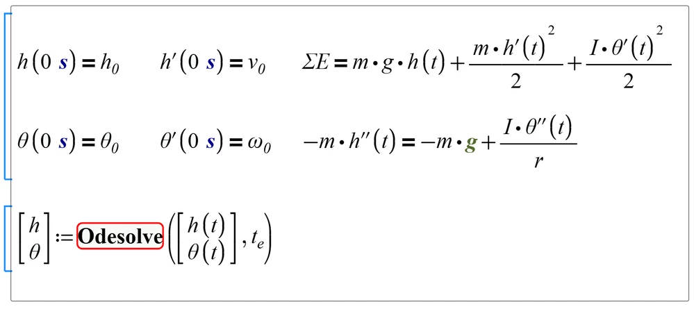

See please new version of sheets in attach.
Mathcad 15 gives as more informative error message.
Mathcad Prime 5 gives as old not informative error message.
Help please!
May be the math model is wrong?

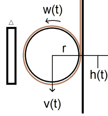

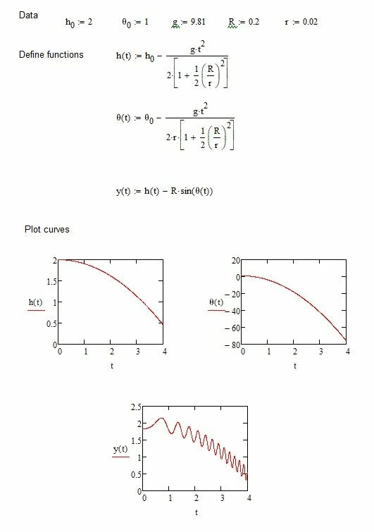

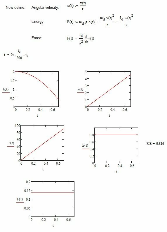

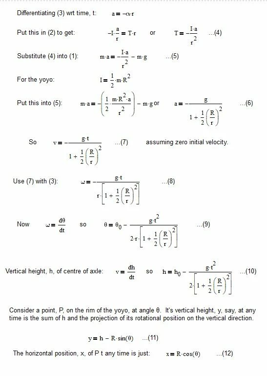

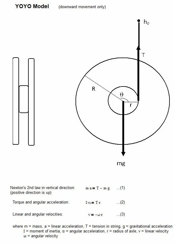

Hmm!  I'm not sure I like your yoyo Val, so I've come up with one of my own!  See below and the attached (M15 version):
Alan
I know! I know! I haven't included units.  I haven't provided an animation.  I haven't done the upward movement.  I'll leave that to whoever is interested!

But I would like to see ODEs solution - not problem, but SuperProblem!
Why me sheets with Odesolve have errors?

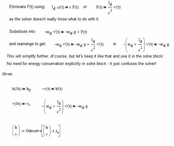

May 14, 2020
Ok Val, I've modified your worksheet so that it works.  The solver was confused in particular by F(t) and the explicit inclusion of the energy equation (which is there implicitly in the other terms).  See my modifications below, and the attached for the complete file (M15).
Alan

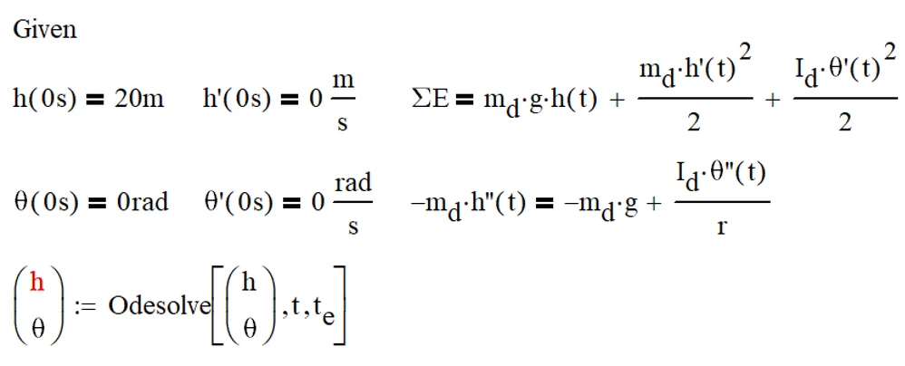

Too few equations! Why? Prime 5 in attach!
May 15, 2020
Too many initial conditions! Why? Mathcad 15 in attach.
