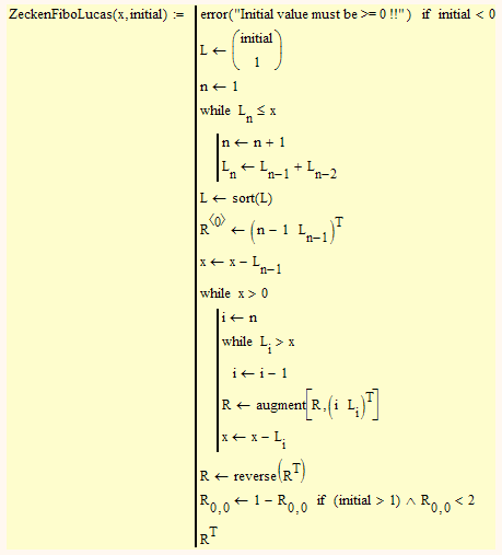

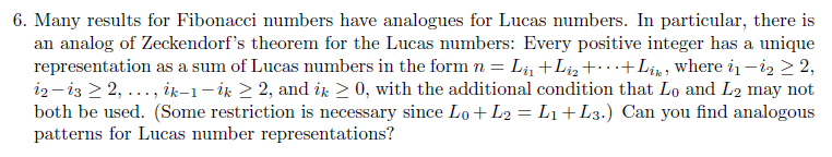

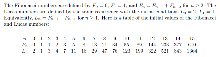

The question is : Need help creating a Program Function for "Zeckendorf Representation for Natural Number (2017) with Lucas Numbers ?
      Thanks in advance for your time and help.
            Best Regards.
Werner_EAnswer
November 27, 2016
Here you are. The problem was that the first two Lucas numbers are not in sequence and so had to be treated differently to return the correct index for the first two sequence elements. This is solved now in a different way and the routine works OK as long as the initial value is >=0

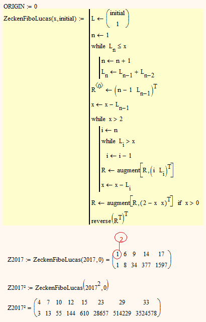

November 27, 2016
Here's a slightly modified version which returns the numbers themselves, too.

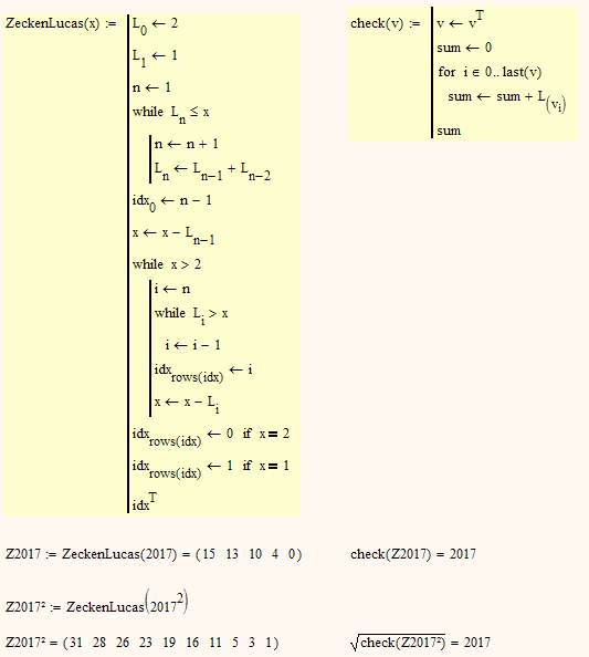

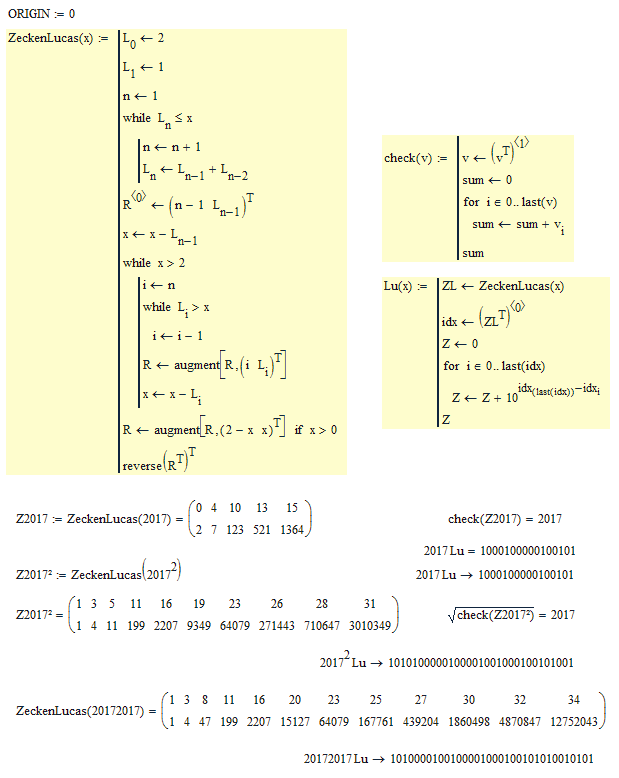

November 27, 2016
Thanks again, Werner. I very,very . And I guess your Program Function could apply for : "Zeckendorf representation for certain Natural number with both of Fibonacci numbers and Lucas numbers :
But I guess : "Zeckendorf representation for certain Natural number with Fibonacci numbers" would choose  F[2 instead of F[1  ???
So could we modify the Program Function above suit with Zeckendorf representation and apply to both of Fibonacci numbers and Lucas numbers ?

Werner_E25-Diamond IAnswer
November 27, 2016
