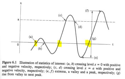

For a random (vibration) signal there are two important statistical values: the peak rate and the zero up crossing frequency.  The first one I was able to compute using a the function localmax provided in the "Data Analysis Extension Pack".  Now I would also need the zero up crossing frequency, that is the number of time the signal crosses the X-axis going up. To clarify here is an image from Wirsching, Random Vibration.  The zero up crossing in the example are highlighted in yellow.

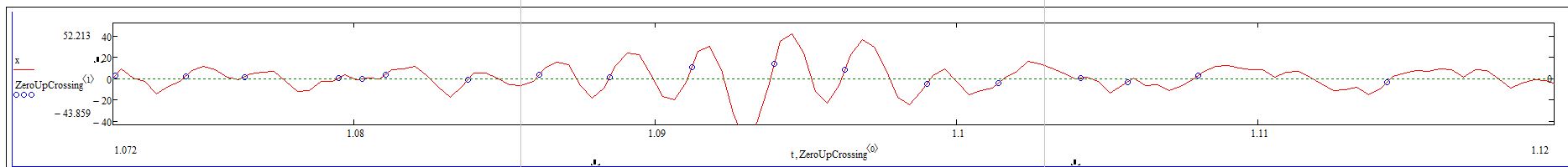

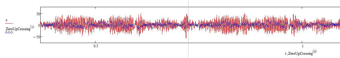

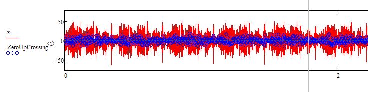

March 31, 2017
Here to clarify (thanks Luc) a few zooms on a signal on which I am testing my algorithm: at the highest zoom it is clear that there are "false positives".
The blue points are just midway between the two data points.  I do not need an exact estimate of the time of zero crossing. The important value is the rate, that is the total amount/duration.

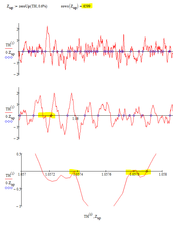

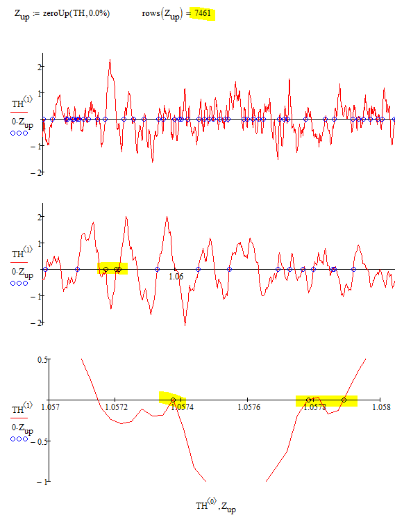

Its not much more work to "exactly" calculate the point of zero
The argument "perc" is a first try to deal with a noisy signal and it defines a range around zero in relation to the full range of the signal which is seen as zero. crossings in that range are not taken in acount.
I am not sure how to deal with a time window in that case - averaging the values in the window would mean smoothing the signal and so we could as easily use one of the available smoothing functions.
See the difference here:
EDIT: Changed a small detail in "zeroUp" in the attached file.
