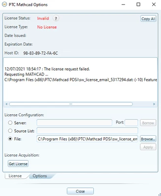

I have recieved a sw_licence_email.dat by my email and I have copy this into the server Computer > C > Programs File > PTC > Mathcad Prime 6.0.0.0, but unfortanly I can't activate my Mathcad. I go to the button "Activate" in right from the program, then "Configure product to use existing license" and in File I browse the file. Than it said "The following products have been licensed. PTC Mathcad Prime 6.0.0.0.", but it is not. What can I do?

Hello @andressakreutz,
Please capture the screenshot of the PTC Mathcad Options license tab and to do so follow the below instructions.
  • Launch Mathcad Prime > Click on M icon on top left corner > Options > License
Vipul
July 12, 2021
The selected file is the one which I have received by PTC's email. I don't know what to do.
Verify the expiration date of the license file.
It seems the license file might have expired hence giving error -10 "Feature has expired”
Vipul
