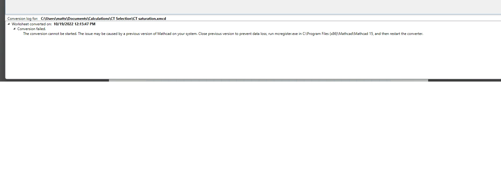

When attempting to convert an old file it gives an error. I have ran the mcregister exe as it requests but also receive an error within the log file that it generates.
Here are the errors that I faced
The conversion cannot be started. The issue may be caused by a previous version of mathcad on your system.

I have attached a screenshot of the error and the log file as well.

With 'old file' you probably mean a (real) mathcad file, one with an extension .mcd, .xmcd or .xmcdz, as generated by Mathcad 15 and before.
For conversion of such files with Prime 4 you need to have Mathcad 15 installed and working on the same PC as where you have Prime 4 on. (This is no longer required with Prime 7 and higher).
Please confirm that you have Mathcad 15 installed, and working, on your PC. This may not be the case due to
the following announcement - "Official PTC Mathcad 15 and Prime 1–6 End-of-Sale Announcement": https://community.ptc.com/t5/Mathcad-Tips/Official-PTC-Mathcad-15-and-Prime-1-6-End-of-Sale-Announce...
Alternatively you could attach the worksheet to your reply and ask if someone will convert it for you.
