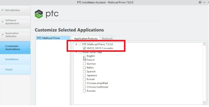

Best answer by VladimirN
Starting from the 7th version of Mathcad Prime you can use the built-in converter (before the installation process, it is necessary to select it among the installation components).
VladimirN24-Ruby IVAnswer
September 22, 2022

thank you for your answer, but I have already installed the tool XMCD, MCD converter, but it doesn't work with the file that I need to convert..
I think that the problem is the file itself.

September 22, 2022
You need to open all hidden/password protected areas in your worksheet..
