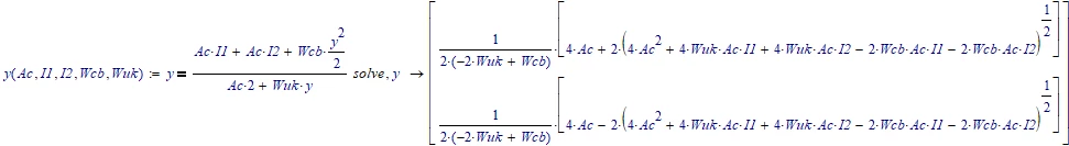

23-Emerald V
May 17, 2026 10:38 AM UTC
Note that you could also solve the problem in a different way. Without any of the numerical values defined (And I've used Wuk to replace the strange ‘13’ which might need to be ‘13 in’) you can get a function as a result:
Now you can call that function with your parameter values, to get (all possible answers):
