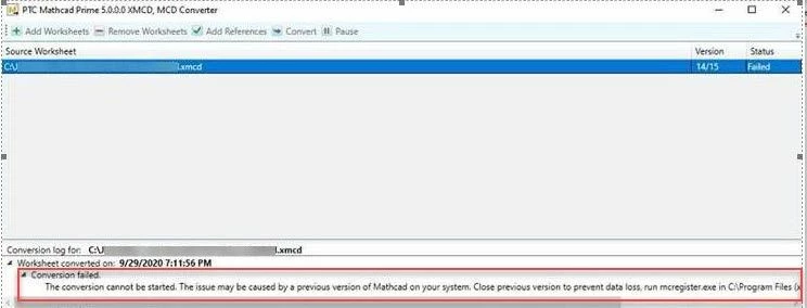

Error "Conversion failed. Could not start Mathcad conversion process".
Issue:
  • Error "Conversion failed. Could not start Mathcad conversion process" while converting legacy Mathcad worksheets in Mathcad Prime
OR
  • Mathcad Prime with parallel installed Mathcad 15.0 does not convert .xmcd files to .mcdx with error message:
    Mathcad conversion process could not be started.
Resolution:
There are two options to resolve this issue:
Option I:
  • Find Mathcad Prime shortcut on desktop > right mouse click > Properties
  • Select Compatibility tab
  • Under Privilege Level section check option check Run this program as an administrator
  • Apply > OK
Option II:
  • Click Start > Programs > Administrative Tools > Component Services
  • Under Component Services, select Computers > My Computer > DCOM Config
  • Select Mathcad, right-click, then select Properties
  • Select the Security tab
  • Click #Edit under #Access Permissions
  • Select the System User and allow Remote Access rights

Hi, I have a similar problem. Conversion fails every time. I have tried the steps above but with no success.
At first the message was that .NET 3.5 could not be found; it is installed; later it said "Conversion failed. Could not start Mathcad conversion process". The exceptions log file notes
Exception data:
System.Exception: E_FAIL_MATHCAD_COM_WAS_NOT_STARTED ---> System.InvalidCastException: Unable to cast COM object of type 'System.__ComObject' to interface type 'mcautomation.Application'. This operation failed because the QueryInterface call on the COM component for the interface with IID '{0F8C5F99-AE35-11D1-B19D-0060971E663A}' failed due to the following error: No such interface supported (Exception from HRESULT: 0x80004002 (E_NOINTERFACE)).
at ConverterLoader.XmcdToMcdxConverter.StartMathcad15ComServer()
--- End of inner exception stack trace ---
at ConverterLoader.XmcdToMcdxConverter.TryConvertWorksheet(String originalFileName, String destinationFileName)
at ConverterLoader.XmcdToMcdxConverter.ConvertWorksheet(String originalFileName, String destinationFileName, String mathcadVersion)
The PC is a Dell Latitude 5540, Windows 11 Professional, Mathcad Prime 8, lots of engineering thermodynamics and music software installed.
