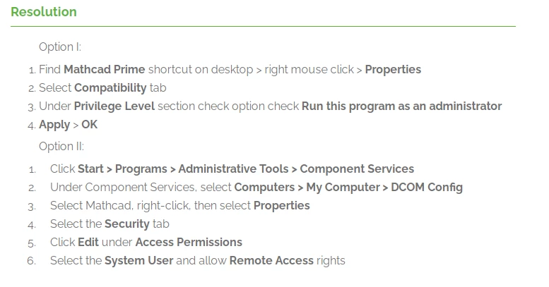

1. Here is the solution from the article - "Error to specific user "Conversion failed. User could not start Mathcad conversion process" while converting legacy Mathcad 15.0 worksheets in Mathcad Prime": https://www.ptc.com/en/support/article/CS103001
Or this tip - "Error "Conversion failed. Could not start Mathcad conversion process"": https://community.ptc.com/t5/PTC-Mathcad-Installation/Error-quot-Conversion-failed-Could-not-start-Mathcad-conversion/m-p/707518#M49

Hi VladimirN,
The solution for me was to set the option "Run this program as an administrator".
Thx!
