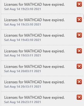

Excessive logging
On the FlexNet server, I am getting License Expired messages every 10 minutes in the log file, but my licenses are not expired!
Why is MathCAD doing this?

What features for Mathcad do you have in the license file?
BenLoosli23-Emerald IIIAuthor
August 20, 2021
#254 1 Mathcad Image Processing Prime 6.0 Ext 02-mar-2022
#255 1 Mathcad Data Analysis Prime 6.0 Ext 02-mar-2022
#256 1 Mathcad Signal Processing Prime 6.0 Ext 02-mar-2022
#257 1 Mathcad Wavelets Prime 6.0 Ext 02-mar-2022
#MATHCAD 1 Mathcad Home Use License Prime 6.0 Lic 02-mar-2022
#MathcadPrime 1 Mathcad Home Use License Prime 7.0 Lic 02-mar-2022
#254 3 Mathcad Image Processing Prime 6.0 Flt Opt perm
#255 3 Mathcad Data Analysis Prime 6.0 Flt Opt perm
#256 3 Mathcad Signal Processing Prime 6.0 Flt Opt perm
#257 3 Mathcad Wavelets Prime 6.0 Flt Opt perm
#MATHCAD 3 Mathcad Professional - Float Prime 6.0 Flt Lic perm
#MathcadPrime 3 Mathcad Professional - Float Prime 7.0 Flt Lic perm
August 23, 2021
Try the following:
1. Backup your license file.
2. Delete this 2 features from license:
3. Reconfigure your license file.
