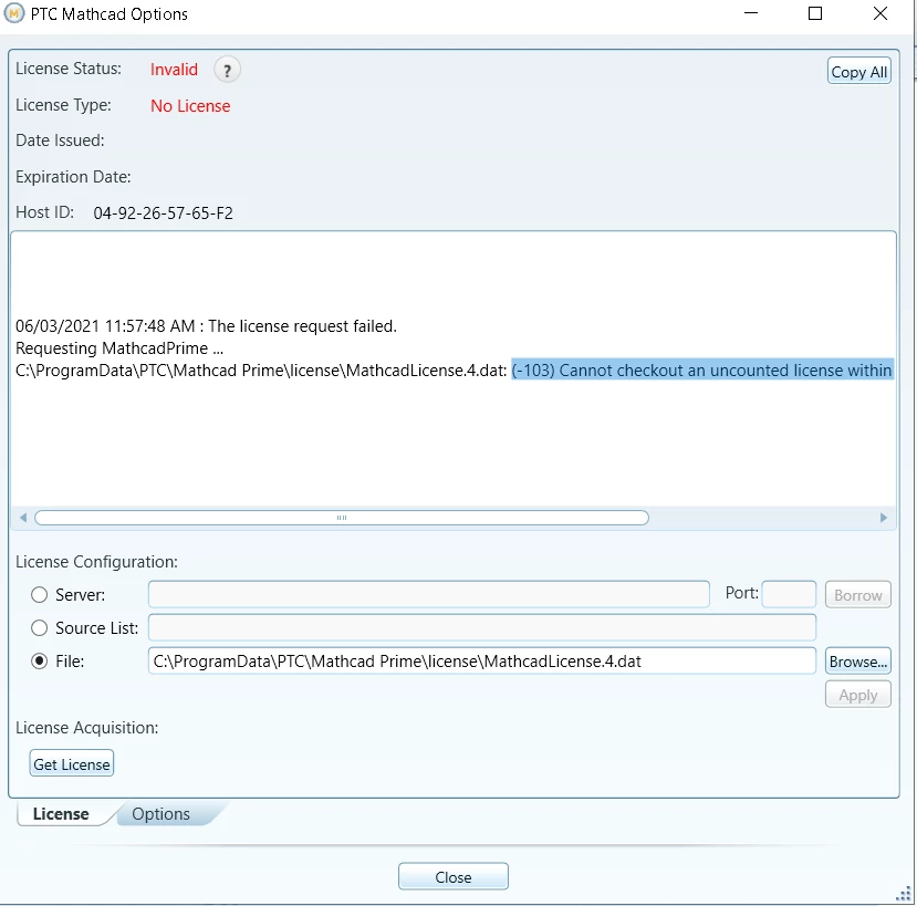

I am having a license request failure when trying to get a 30 days free trial for PTC Mathcad Prime 7.0.0.0

I did this but still the same error. Here's the error I am getting. "(-103) Cannot checkout an uncounted license within a Windows Terminal Services guest session."
June 3, 2021
Hello @LP_9956387,
What is the error message that you are receiving?
It would be great if you can attach the screenshot of the error message
Vipul
June 3, 2021
Got this error "The license request failed." and "(-103) Cannot checkout an uncounted license within a Windows Terminal Services guest session."

@LP_9956387,
If node-lock license is configured, PTC flex-enabled application cannot be accessed via Remote Desktop session or Terminal Services connection
Please refer Error: "Terminal Server Remote Client Not Allowed" or "(-103)". for more information
Hope this helps
