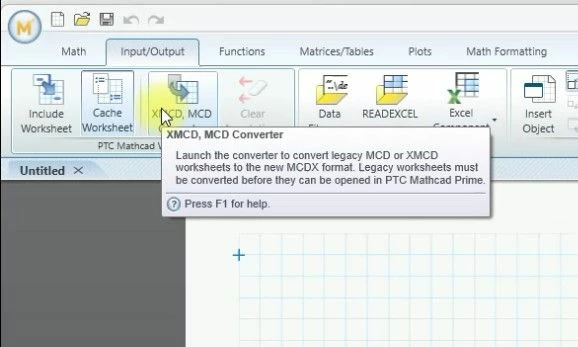

I have old mathcad files that have the extension .mcd. I downloaded a free trial of your software but it is not opening taht file extension. Is a way to convert these files to .mdcx?

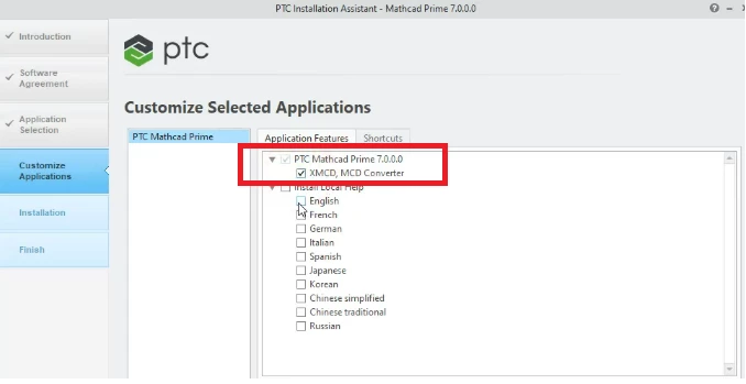

When installing the program, don't forget to point to "Converter":

It is necessary to convert the files from *.mcd to *.mcdx.
A converter is provided
Cheers
