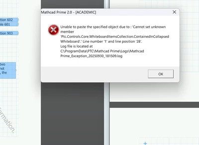

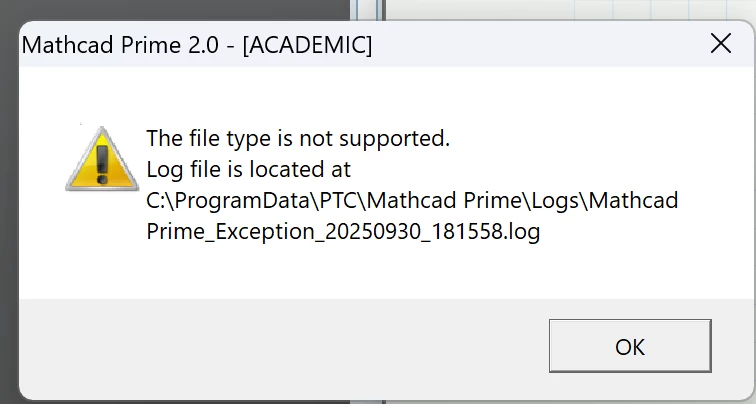

Thank you for your response.
The first picture is how it looks when I open my old files from Mathcad Prime 11 into the new software my school gave me (Mathcad Prime 2.0) and the second picture is how it looks when I try to copy and paste the contents over from 11 --> 2.
