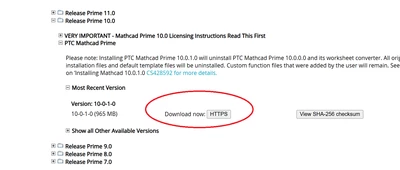

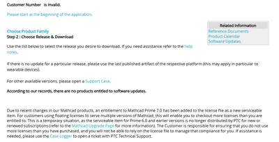

I go here but I don't understand what I need to do next. Do I need to add something from my companies side?
18-Opal
May 29, 2025
Expand as shown and click on Download Now button
