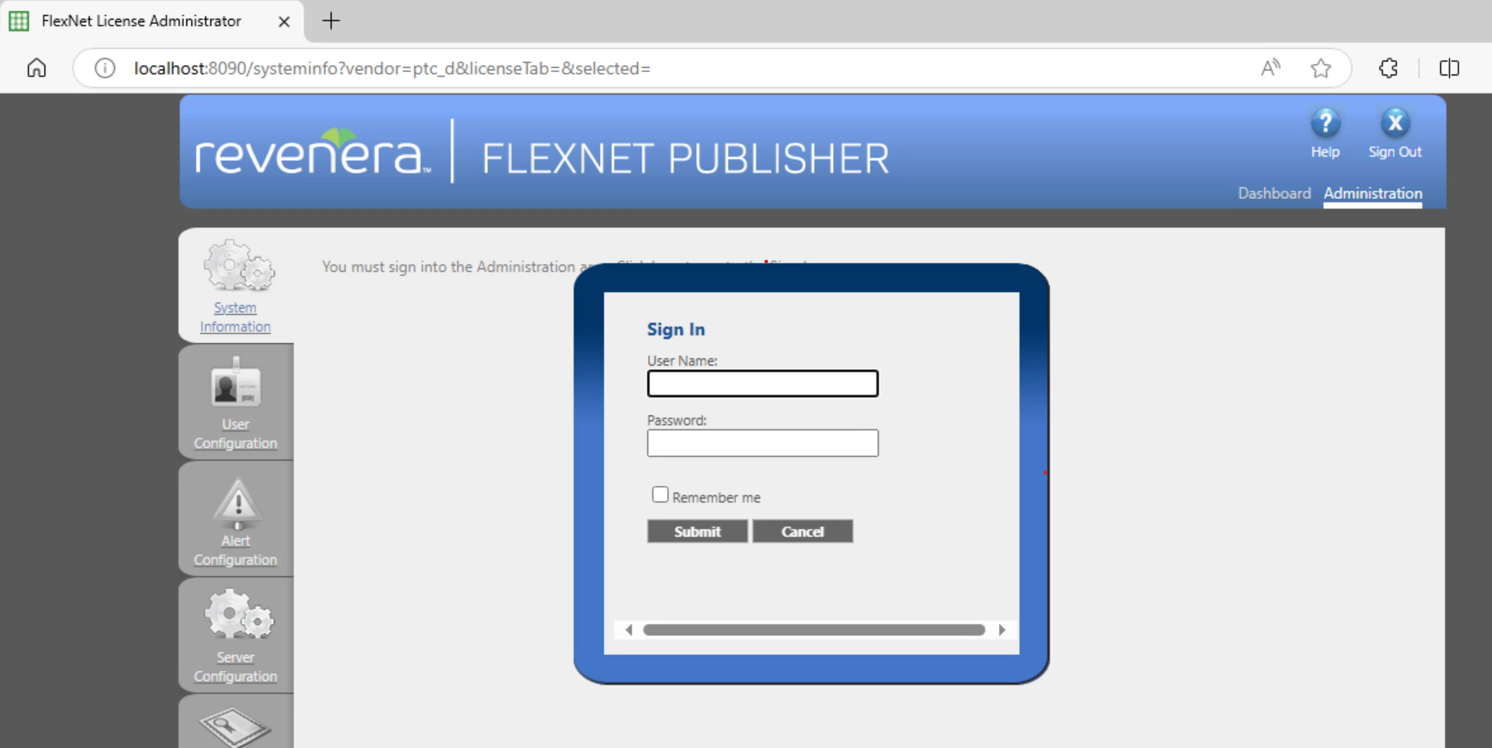

How do you remove a concurrent user from a floating license using FLEXnet Admin?
I've not been able to locate anywhere on how to remove a concurrent user from a floating license pool of licensing using the FLEXnet Admin.
Also when I go to the Administrator section of the FLEXnet Admin tool it is asking for a administrator login, however I'm not sure what login information to use because it is not accepting my PTC login information or my server administrator login, so I'm not sure why this is not working.
Please provide any insight or advice on this.
FlexLM has its own password set by default when the software is installed. It is in the FlexLM documentation unless your company has changed it, which they should.
What do you mean by 'remove a concurrent user'? There is no user name list in FlexLM. You can use the option files to restrict who may obtain a concurrent license.
